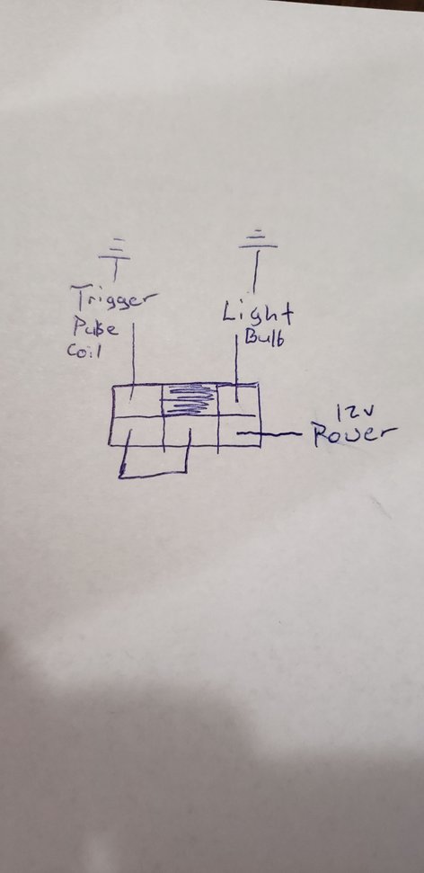

cool so the pinouts on these should be universal so the wires are really whatever the manufacturer decided to use. we are going to wire the cdi up and see if it will
flash the light bulb when magnetically triggered so your spare parts will come in handy. so your going to use your spare cdi first and the pulse coil from the old stator and some wire. wire it up like the picture and pass a magnet over the pulsed coil see if it lights up.
the two outlets on the bottom left are just jumpered together to bypass the kill switch

​​​https://drive.google.com/file/d/1eX1...w?usp=drivesdk
So, I couldn't find my old stator and used the new one. I've included a pic of my "wiring" on my old cdi. I didn't remove the pulse coil but just used the wire from it.
I never got the light to come on. Checked to make sure it was working. I used a 12v shop light, it worked when direct connected to the battery but not when I used the "jig" you suggested.
I did wire the pulse coil and light to battery ground. Also used a magnetic pickup stick( cheap ones to pick up bolts and dropped sockets). It would stick like it has an attraction but no light.
