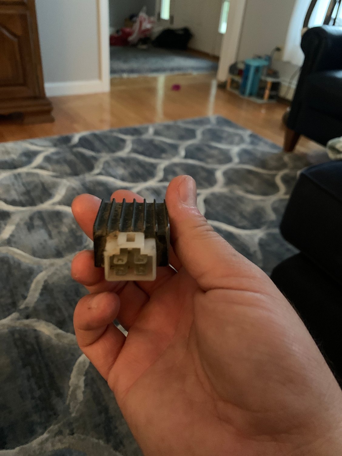

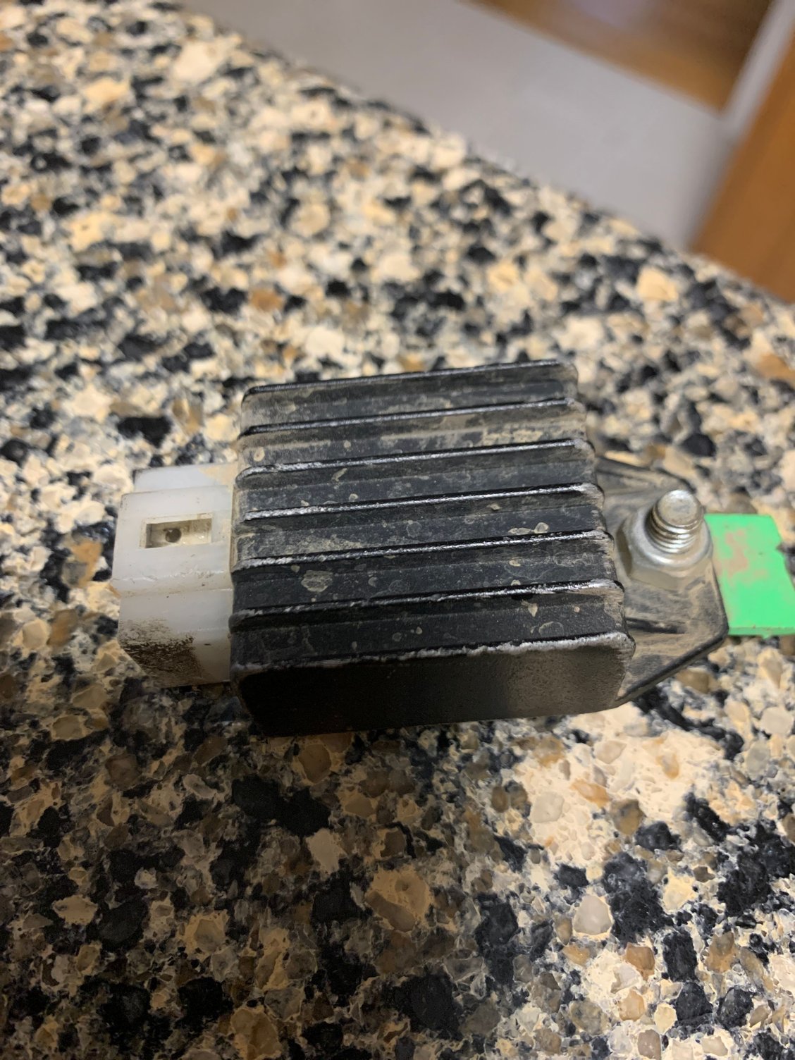

What is this? Is this the CDI?
4 pin connector. The opposite side of the connector has only 1 wire running to it. Three others severed. It appears as two of the three are tethered together. Lights inop, and key system doesn’t shut off kart. But does start it
