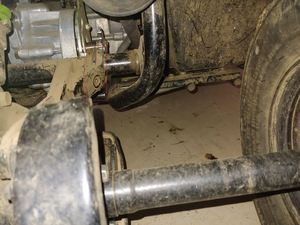

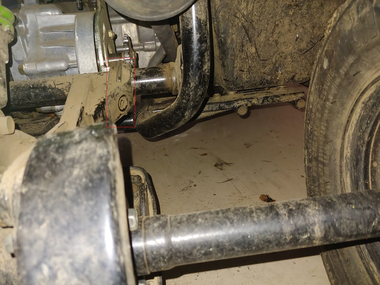

1. What is the rubber part that it hit (in red square)?

!. The rubber thing will be to protect the swinging arm pivot tube from the chain rubbing against it as the suspension goes up and down. From the dirt on it, I would guess the chain hasn't been hitting it much.
2. Can't make out what that is in your picture.

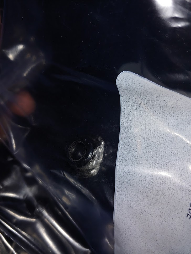

Yeah, the rubber part has never been touched by the chain until it snapped. The washer looks like a cup. You can actually see it in the first picture where it secures the rubber part, but this one was from the other side that got hit by the chain. Sounds like I can just grind down the damaged area and reinstall.
