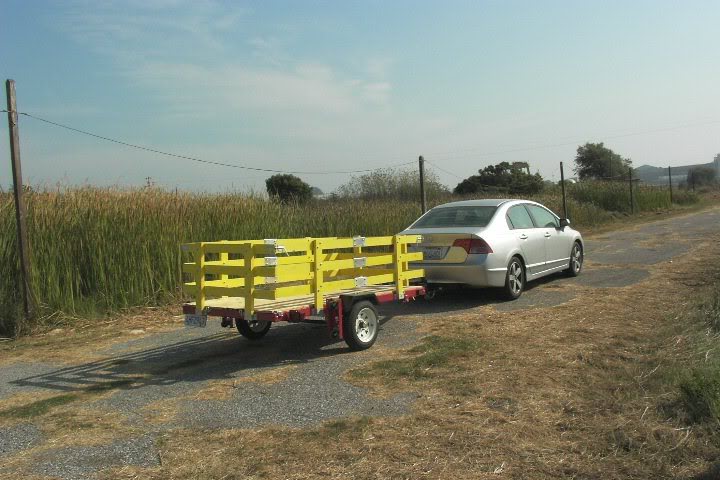

...I would take the thing to a shop but I don't have, nor do I know anyone with a truck...this is such a pain...</end quote></div>
Neither do I, but that doesn't stop me. This is what I do:
My wee little honda civic hauls around my quad no problem. The trailer I got from HarborFreight.com for $250 (the yellow stakes were a little more).
This is one of the best dang things I ever bought. But there's more than just what you see. The trailer tilts to the ground like a dump truck, and I just drive my quad up on board. After I'm done, the trailer folds in thirds, tilts up vertical (onto those little caster wheels in the back), and stores in a corner of my garage taking up only a 2 foot by 5 foot space.
Who needs a truck? I get 38 MPG in the honda. When I need to haul I hook up the trailer (and get about 26 MPG).
