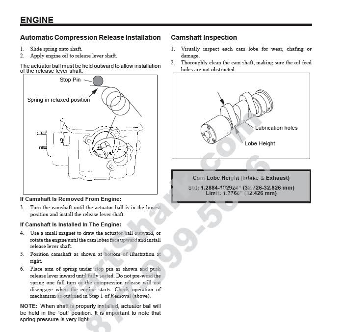

Hi I am new to Polaris and I think I have done something dumb. I went to pull the thermostat housing off and there was a cover next to it I removed...when I did the rod with kind of a half moon shaped thing and a very light spring slid out...I slid it back in and tried to put the cover back on and can't...it will not slid back in all the way...help
Old Oct 21, 2016 | 08:31 AM
You pulled the cam detent device and spring out.Use the recoil and slowly turn the engine over while gently pushing in on the detent assy. The decompression ball on the cam has to be facing towards the bottom of the cam for the arm to slide all the way back in. The spring has to fit properly also or the engine won't run worth a flip. Look at the diagram(step 4) on inserting the rod and how the spring must go. If assembled correctly you can push up on the detent and it will spring back to the stop.
Attached Thumbnails 2005 sportsman 500 hot-check engine while cold-ff1tv7.jpg
