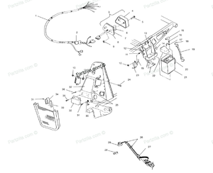

Yea it is looking that way now. Crap! Might have to eat that cost now . I have took one off my parts quad and it is part # 4060191. It appears they are similar but this one does not fit where the old one was bolted up. Does this regulator need to be bolted in for grounding purposes? I was thinking of just zip tieing it in for now.
Old Oct 21, 2017 | 05:23 PM
  #17
Should have a little aluminum heat sink strip that the regulator mounts into and the frame. Helps dissipate heat from the regulator. Item#33.
Attached Thumbnails 97 Polaris 425 Magnum Electrical Issue-38b6dcda04317ee87c676656b7cf714ad7a578cd.png
