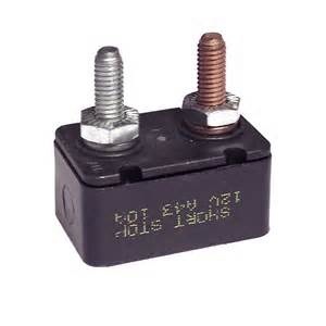

Don't use an inline fuse. This breaker kicks off and on if there is a problem.Very easy to replace if needed. Just check that you have power to each side of the red wires leading in and out of the pouch,BUT if terminals are corroded,may show good until it heats up and trips. Just slice open the pouch. Ecm mainly controls the charging to the battery and power to the fan,but can short out causing problems also.Really no test on it,just check that the battery is charging 14-14.5 volts while running. Fan also uses a thermistor sensor in the oil cooler that goes to the thermistor module under the front panel,but both these rely on the ecm also. Best to have a manual that you can look over that shows help on repairs,trouble shooting and maintenance.Here's cheap one.2004 Polaris Magnum 330 Service Manual PDF Download
Plus here's what the circuit breaker looks like.
