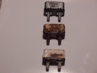

Both these areas are common problems on not electric starting along with no power to lights,etc,but you can usually pull start. On the older models the ignition is magnetically triggered not electrical triggered. The newer dci ignition systems that have to have the battery for ignition. Check that the two connectors on the left switch are clean,use dielectric grease. Slide the on/off switch back and forth to remove any corrosion from the contacts. On the sealed circuit breaker up from the battery check that you have power on the red wires on each side of the pouch. If you just have power on the battery side,split the pouch open and check out the breaker for corrosion. Even though sealed they're not water proof. Here's an old one and new one. You can get them at any auto store for a few bucks.
