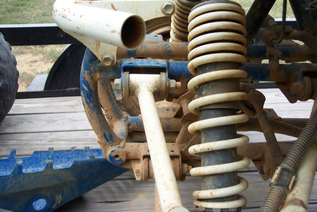

Does anyone know for certain if these will work in my 1988 model?
I have both the arms off, and neither one of them have a spherical bearing, or a place to snap a sir-clip like is mentioned in this ad.
Lower A Arm Bearings Seals Kit Suzuki LT230S 1985-1988

Originally Posted by jmauld
Will these bearings work in the '88 lt230s a-arms?
Both Lower A Arm Bearings and Seals Kit Suzuki LT-250S LT250S 1989-1990
To answer my own question. NO, these will not work on the '88 model. The inner diameter is too large. It might work, if I could get a hold of the spacer from the 250s model.
Are you sure you don't have the 250s model?
Positive it's not a 250s. I'm not positive about the year. I was thinking it was an '87 but someone suggested that it was an '88.
It doesn't matter. The 87 and 88 are nearly identical. So why do you need a spacer from a 250s? All years of the 230 have the same frame. A 250 spacer wouldn't fit in any 230 frame of any year.
230
250
