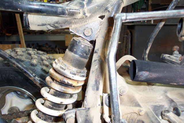

I figured since I had the carb off anyway,,,, I might as well cut the rear shock mount down like I've been pondering for weeks. I cut about an inch off and drilled another hole for the shock bolt. I have a seat height of 29inches now,,, unloaded.
Since my axle was down low draggin rocks anyway, might as well lower the frame some too and get a lower center of gravity. I don't think I'm really giving up any ground clearance either.
If you decide to do this too, make sure you drill the hole in exactly the right spot or you won't be able to get the bolt in or else the spring will rub the frame. I got pretty lucky, I only had to do a little rat-tail filing.

So based off you gaining approximatley an inch on your rear shock by cutting off some of the mount, would you be able to use a shock that is up to an inch longer then our 12.63" oem shock? (Assuming the shock eye is not to thick to fit in the shock mounts). Of course this would raise you back up to the original height but I was thinking it would open more possibilities for using "other" rear shocks.

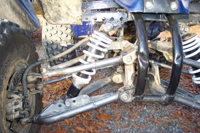

Well, first let me update how it rides with the shock mod.... I can slide around now like wet grass! That's what I was after. The down side.... I can't ride a wheelie to save my life! I can either flip all the way backwards or just not be able to get the front end up. No in between. I'm thinking because the tires are 2 lbs heavier and 2 inches smaller and being 1 inch lower to the ground are the reasons.
Yes, you should be able to put a long shock in the back if you cut the frame like I did. I have no issues with the back shock myself.... I just want the front a little softer, but not dive in the turns either.
Yeah, even if you find that 250 arms will bolt right up, you will still have to play around with the geometry for the shocks. That's why I have mounting holes everywhere on mine,,, it took me a few times to get it right. If you know how to use autocad, that helps a lot. I'll take a pic and post in a few minutes showing what I'm talking about.

Using the outside holes makes it stiffer. A longer shock could mean going out or in, who knows how stiff they will be.... My arms can't go down anymore because of the balljoints, so the top of the shock will have to be mounted higher or the bottom of the shock will have to be mounted lower. Either way, looks like I will have to weld a new bracket.
