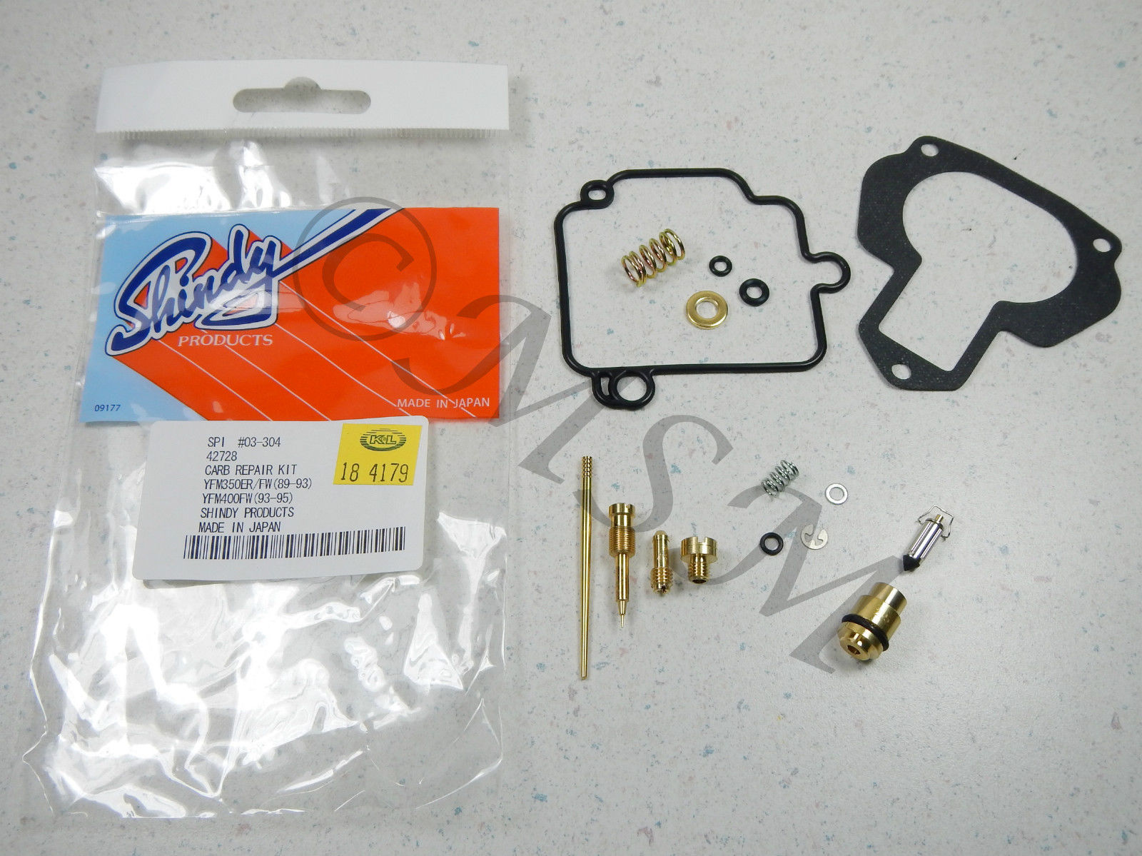

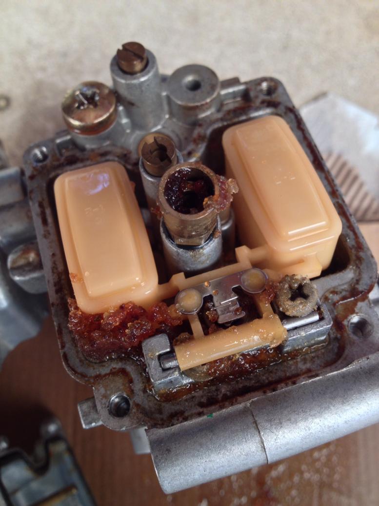

I'll play the devils' advocate on this one.. Cars aren't simply play things that are used at owners leisure. They are driven constantly. Comparing them to atvs or even motorcycles is like comparing apples to oranges. Plenty of fair weather riders,hunters that use them a couple months out of the year,etc. Rare that any atv is used on a full time basis unless used on a farm or ranch. Sitting up just allows the crappy ethanol fuel we get today to eat up fuel lines,o-rings and float needles. Float needles are the most affected especially those that are rubber tipped. Over the years I keep reading over and over about people that have gone through carbs 4 or 5 times and that are still leaking, which is ridiculous. Once should be enough. Oem needle and seats or just the float needles are costly compared to what you can get in some of the better quality Japanese kits such as Shindy. The kit with all new gaskets and parts cost less than just the needle and seat in most cases. When I see carbs like this,it gets a new kit.
