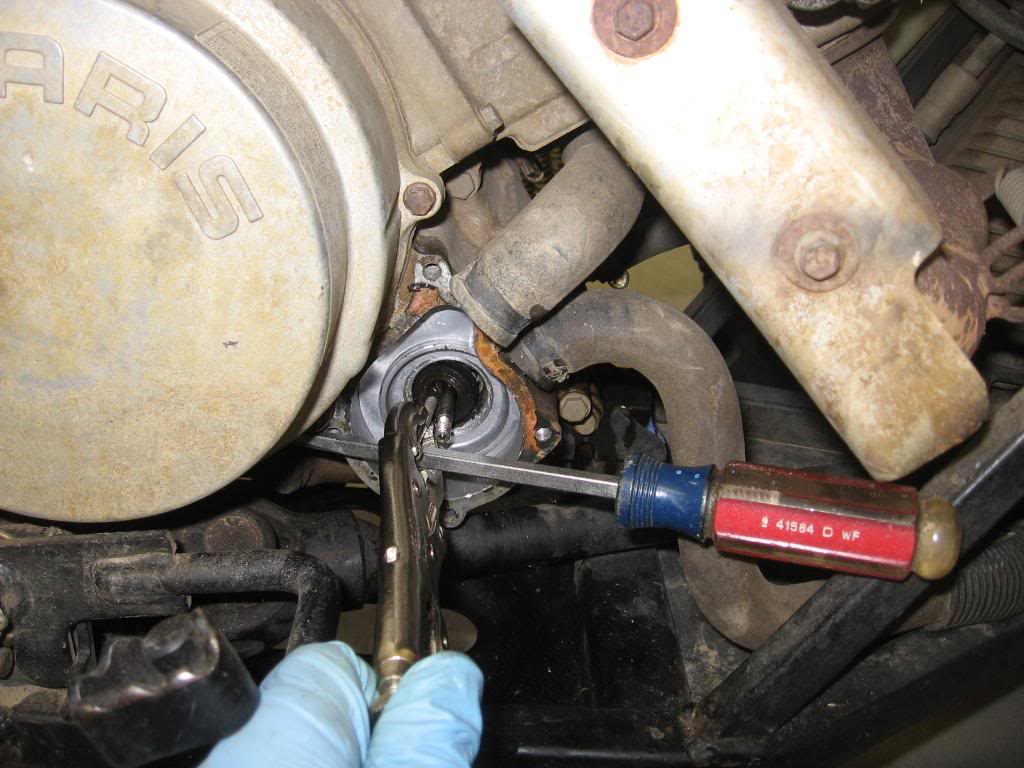

My friend did the rear output shaft on a 350 Big Bear, I don't remember him having to taking the whole thing apart.
I would change it(#8) from the outside using this screw trick.

Opps my view (#8) was the rear output seal ,sorry. No matter, from the above link it (#44) looks to be changed from the outside.
