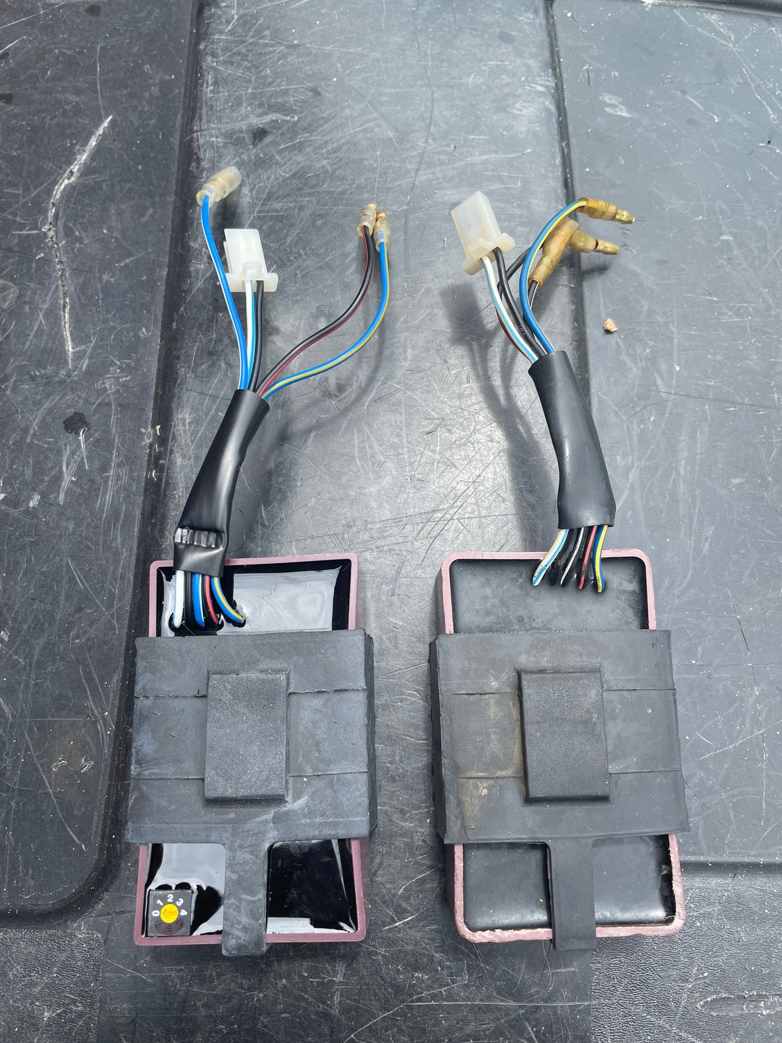

OEM CDI is on the right and the adjustable is on the left
all colors are the same, accept the OEM black/white stripe is blue/white stripe on the new CDI

Have you wound the limiter to the max? If 0 does mean no spark at zero revs, you won't get a spark at 0.
Black with white stripe is almost universally kill switch on CDIs. Try leaving that blue/white disconnected on new CDI, try with it earthed if you don't then get a spark.

I have tried all the dial positions while turning over, no spark. Tried with kill switch in off position. Never tried with disconnected, I will try that.

Right, looks like that wiring set up is, as I suspected, earth to run for the kill switches. If your new CDI is earth to kill, leaving the kill wire disconnected would give a spark. Though trying with ign off would have the same effect, how did you turn starter with ign off? Only other possibility I can think of is a dud new CDI. Has your thumb throttle got a tapped hole for a throttle restrictor screw? Would save all this messing about if you fit one.
