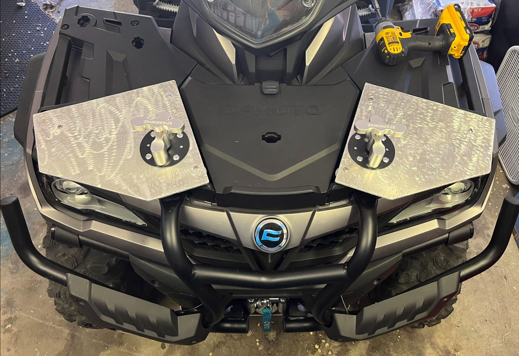

I also made my own...... I used 3/16" Aluminum Plate.

anyone done something simial....
