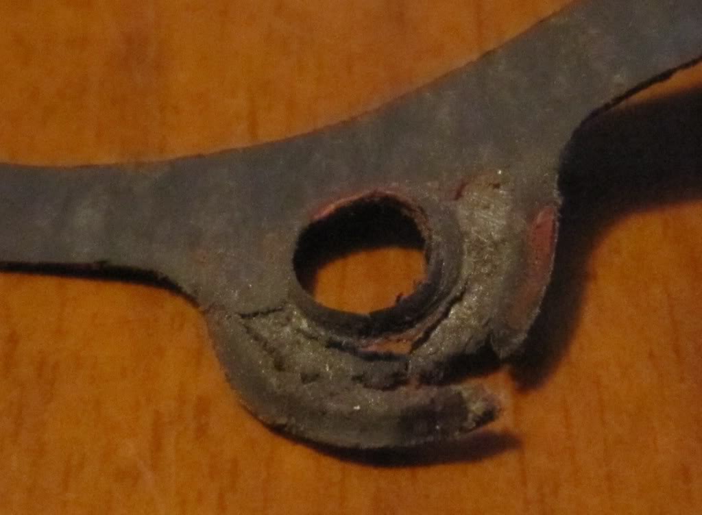

This is the gasket, not in horrible shape I am going to try to fix it up with some of this gasket seal I got at work, it is only ripped on the outer edges of the bolts anyway.

Then I cut off any ripped edges of bolt holes on the gasket, marked where they were missing and applied gasket sealer to the block. Installed the gasket and tightened it down.
