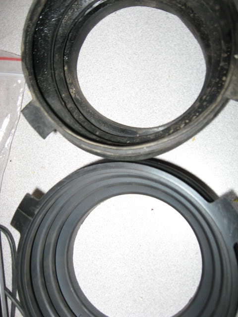

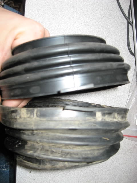

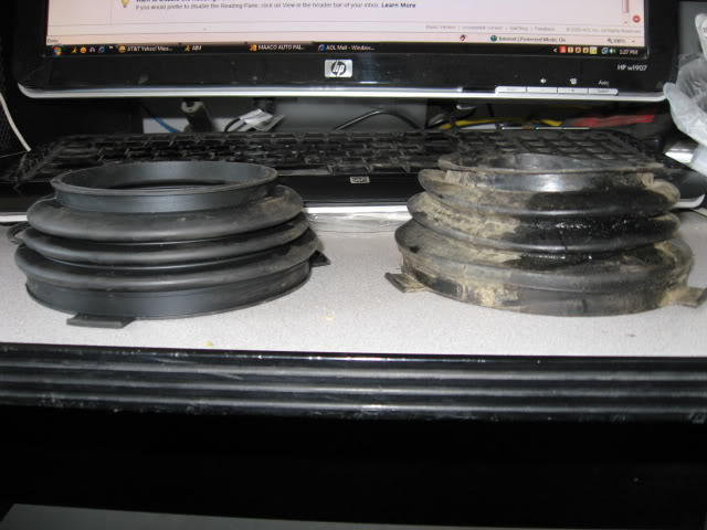

I have a parts update. My parts from Tanks Sports have still not arrived but I did get the rear end parts I ordered from Yamaha today. The parts are identical except the chinese quality is horrible compared to the Japanese. The rear differential housing and components are identical but anything made of plasic or rubber is duplicated and not in a good way. The rubber is cheap, half the thickness and flimsy compared to the japanese yamaha rubber boot. The Yamaha boot is probably twice as heavy as the Jianshe one. Here are some pictures comparing each part.

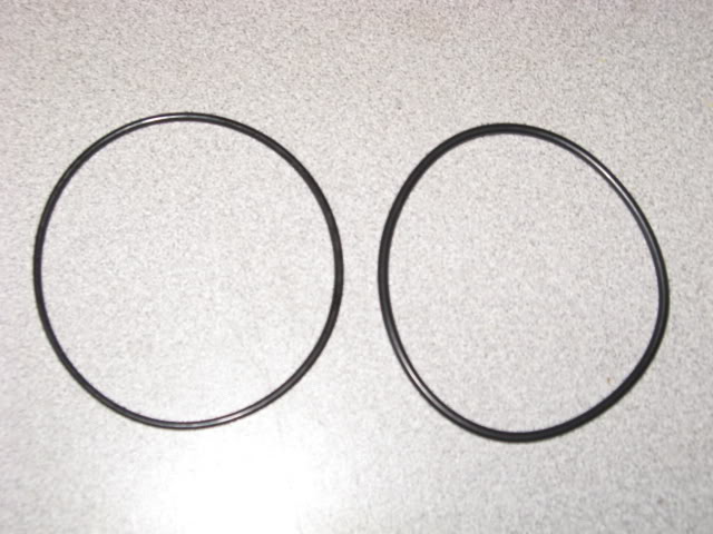

Here are a few pictures of the o-ring seal. The new Yamaha one is on the right and thicker

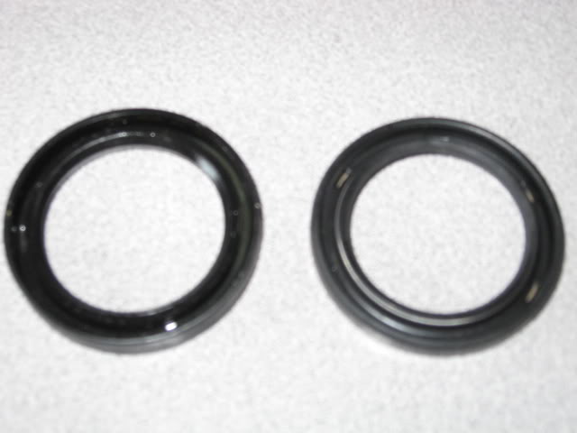

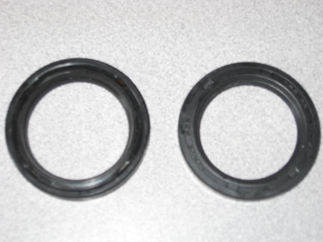

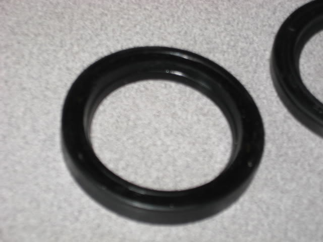

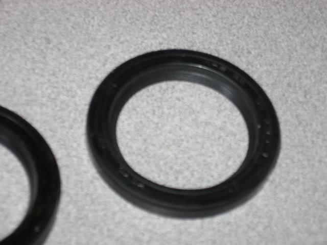

Here are pictures of the Yamaha Seal on the right and the chinese Jianshe seal on the left. The yamaha seal has a spring on the back side of it to seal the drive shaft.

I have come to the conclusion that Jianshe/Tank Sports 400U atv's may be a close duplicate of the 2000-2006 Yamaha Big Bear 400 4x4 but fall way behind when it comes to quality control and build quality. For the price I paid I really can't do anything but deal with the issues as they come. The one nice thing is I can buy these parts at a local Yamaha dealer. I bought an oil filter also and it is identical to the yamaha one. I wouldn't recommend this atv for someone who doesn't know how to turn a wrench because most likely you will be doing plenty of wrenching while owning a Jianshe. I guess we'll see how everything goes in the next month or so. I should be able to get the atv out this weekend and will keep everyone updated. I will also let you all know if I recieve the parts from Tank-Sports on wednesday. I want to thank everyone for their help throughout this also
