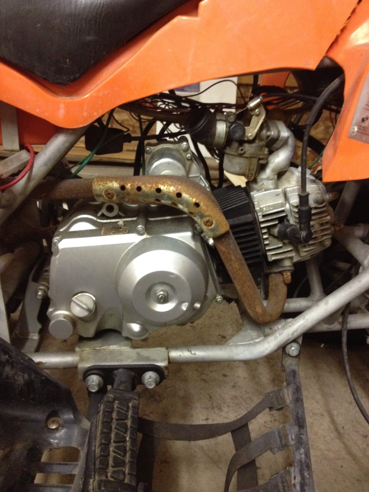

Hey all, new to the forum. This quad I picked up for pretty cheap has no markings, labels or anything, need to get some support information about it if anyone can help. Thanks!

Maybe post the vin that is stamped on the front bar under the front plastics

I seen those motors before, I think its used in many Asian brands.
How do you know its a 50cc?
looks like this motor and they come in 125cc, 110cc, 100cc, 90cc, 70cc and 50cc

Actually, not sure why I didn't see this but it looks like the same engine in my sons 70cc Jialing Redcat I sold last year. I need to restore a bunch of pics on my thread I had, but I restored some.

Almost every Chinese maker has gone off the two stroke scooter engines onto this one, for machines under 125cc. It is a clone of the Honda C range, C50, C70, C90 etc. This was used on Honda's legendary small "step through" Cub motorcycles. As for the frame, that triple nudge bar and webbing in front of the foot pegs is distinctive, though used on a few different makes. The frame and plastics look standard issue, so no clues there.

Great, I appreciate the feedback, more than I have to work with, that is for sure. That engine you posted looks very similar if not exactly, I'll look a little closer for a VIN on the front bar tonight. I was told it was a 50cc, that is really it. Is there a way to tell for sure? Also the carburetor, are these pretty standard and easy to get rebuild kits for? I will probably ask later once I figure out who made this thing about wiring schematics, since the wires are going everywhere since the last owner, I just want to make sure everything is where it is supposed to be. Thanks again.

I figured it all out I think, it is a roketa 110 cc. (117 mL casted on block/cylinder)VIN Plate Labeled ATV-79 (type) manufactured 12-2007. I found all kinds of replacement parts for it, so that it good. Unfortunately someone has done a number to the wiring harness, cutting, splicing, taping, etc. I need to go through it and make sure everything is hooked up correctly. I am trying to search online for schematics, and most of them that I have found are not very good quality and do not label the colors very good. Is there anywhere that I can get one for this ATV that is worth a crap? I seen someones home-made schematic on here which was awesome, but the colors don't match up for mine. If anyone can point me in the right direction, it would be great.
